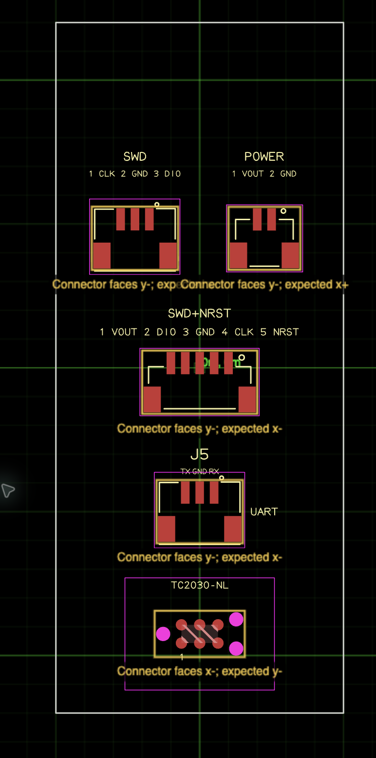

https://tscircuit.com/rushabhcodes/fidget-counter#3d <@778624824875941908>

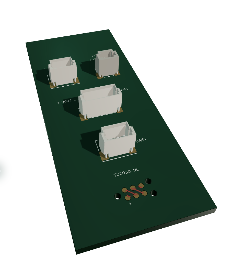

we don't program with test pads, you need to add a tscircuit.com/tscircuit/standard-jst-programmer JST connector
probably the 5 pin connector
yeah but i wanted to minimize the height of the board
we'll add that now
you can use the horizontal jsts which are lower, if you really want to use test pads, you have to use a special standard which the programmer supports, look the bottom test pad connector https://tscircuit--standard-jst-programmer-v0-8-0.tscircuit.app/#file=circuits%2Fupward.circuit.tsx
